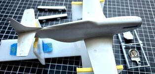

Have the blue painted The steps follow. First it's all white, polished Alum inside the wheel door, and the top of the flaps!
Next, I printed the side pattern and cut it carefully with a Sharp knife.
Then taped it in place to the side of #6. Cut thin 1.5mm strips of tape and followed the paper, care-full-y!
Now This little Godhand, $$$ grooved sheet would be difficult to make. But for trimming Accurately it is a must.
I cut tape in 8 and 9mm circles, scalpel and steel template, for the corners.
Glass is one of them Godhand things, $$$$. A small piece of tempered, Toughened, glass will do!
Covered the lot with copious amounts of tape. I do use Frog tape for Big areas, but I do use Tamiya to hold it down!!!!!!
Painted away with our Aussie SMS languors. Dries while I clean-up the old Old OLD Paasche airbrush!!!!!!! BAM.
So now it is Blue and White!!!!!! Everything is painted. I do have the crew list for the Outside gear doors. I will attach them.
I still have to mimic the windscreen tho? May use a metallic, Maybe pol Alum, dunno.

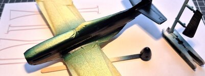

So now What??????????????????? It must be me! I can't imagine Airfix getting bits *%#@*!
So you can see by my handwritten notes the problem I ran in to. I musta done somethin wrong.
My solution; 1 & 2. drill a hole in each big enough for the outside of a sleeve, (4).
Drill a "snug fit" hole enough for 3, the too F'n short prop shaft. It has to be a bit tight for everything to spin.
However 3, has to be Short enough for the Hub to fit in the prop hole. It is about 3mm long!
#3 sleeve is glued in the hole of #1. Then the Prop spinner is the attached to the backing, #1.
