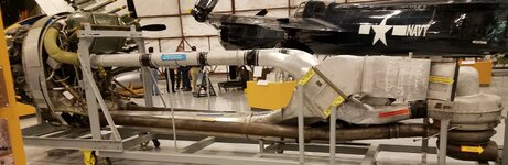

Here's a few other images related to turbocharging, etc.
B17 inboard firewall, shows on bottom right duct of exhaust to turbocharger; B17 Turbocharger on outboard engine; BMW801TJ, turbocharged BMW for Ju388; blown out turbocharger from a R1830 caused by piston-eating valve;F6F Intercooler; Hirth Turbocharger from BV155; P47 turbocharger system displayed at National Museum of WWII Aviation, Colorado Springs; piston eating valve; power recovery turbine in a R3350; Turbocharger spares.
Good photo's Tony! The detail of the 801 TJ and the Hirth Turbo for the DB 603 of the BV 155 are rare and good to see, Thanks!
