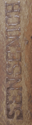

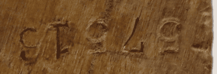

Is there any way to identify how old this propeller is or what plane it would have been used on.
I really don't know the
first thing about some of this stuff. It is 8'4" long. The hole in the
center is about 3 1/8 inches ID and it looks like it would receive a
shaft the length of 5 3/8 ". It was a little hard to read the SER number
on the the thing, but I think it is as follows: 57316

The 225HP rating (Continental R-670, Lycoming R-680, Jacobs R-755) is typical for the PT-13 Stearman, Cessna T-50, UC-78 and a variety of Waco's. There are probably others as well.
100A is superseded by 100CC & 100CD. Those letters indicate minor changes but FAA says approval of 100A expired and no prop manufactured after February 15, 1945 is eligible for use on certificated aircraft. Since this prop wasn't used on military trainers, I suspect that production stopped well before 1945. The "100" is the diameter in inches. If the pitch isn't marked on it, you'd have to get that measured to determine what engine it would match. "Lasher's Approved Propeller Installation Reference Book" shows it as only being used on Wacos.
