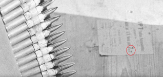

0.50 caliber ammo belt?

Here's a 239 getting its portside wing .50 cal loaded. According to Kari Stenman the photos are dated 16 September 1941, while the photo descriptions give the place as Immola Airfield, Lappeenranta (the previous images were probably specifically from there too). Photo L. Johnsson via SA-Kuva. SA-Kuva #49525, 49526 and 49528.

EDIT: Although, what bothers me a little now is that in the previous images they were filling the box from the side (?) and here they're filling it from the top. So is it even the same type of box?

This second set looks like real 0.50. One can compare the round size with palm size. For the first set of pictures, it looks quite small round.
You may well be right. I just noticed this on the second photo:
If these are 7.7 mm (.303 cal) then the photo description is wrong, which unfortunately is the case on these wartime photos from time to time.
US .30 cal ammo was about 3.34in (84.8mm) long. depends little bit on the exact bullet but too long and you have feed problems.
US .50 cal ammo was about 5.45in (138.4mm) long. depends little bit on the exact bullet but too long and you have feed problems.
US .50 cal ammo was about 30lbs per 100 rounds linked.
