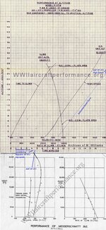

The P-47 was pitted up against a Fw-190 in a climb comparison, and the P-47 overheated slightly where as the Fw-190 did not. Its hard to tell what engine settings the P-47 was tested at. ei 2300hp or 2600hp, but its clear with later models producing 2800hp that this overheating would probably be worse.
However the P-47 did receive an aerodynamic upgrade with the XP-47J. The AAF tested the XP-47J's top speed to be limited to the amount of power it could produce at higher altitudes, but non the less, it was still extremely fast at altitudes where it produced maximum power. Yes there were other design changes to the XP-47J, but its a question of why the American's kept with their "if it ain't broke, don't fix it" philosophy.
484 mph (779 km/h) at 25,350 feet (7,727 m)
This is 31mph faster then the fastest allied fighter, the P-47M. Which used a similar engine and turbo configuration
This is faster than any piston engine fighter plane of WW2. Republic claimed a higher top speed at higher altitudes exceeding 500mph at around 33,000ft. This is now encroaching on the Me-262 top speed. Could the Me-262 have been a large enough threat could the P-47J been enough to counter it at high altitudes?
The engine cooling fan and improved cowling design benefits:
Engine Cooling
Top Speed
Cursing speed(which than grants you better range also shown with the XP-47J)
What would be the downside? Obviously its not power related as the offset in powering the cooling fan is clearly surpassed by the more streamlined design. So what's the deal? Why did the Americans not care for the cooling fan like everyone else?
