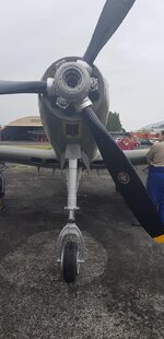

Thank you for your prompt response to my inquiry about the prop hub, which turned out to be a Ratier hollow shaft electric propeller system. I have passed that info on to the two volunteers who are working on this item. Since we at the Freeman Army Airfield Museum are dealing primarily with captured German equipment, I imagine the hub came to us originally on a Bf-109 variant.
Larry
Hi Larry,
I suspect that your Ratier hub probably came on an ex-German operated but captured French-built equipment such as a Dewoitine D.520, or other.
I am certain that no German WW2 Bf 109 variant ever had a Ratier propeller.

Ratier prop hub mystery solved. The German Henschel Hs 129 (we had at least 1 here at Freeman Field) used a French engine and the Ratier prop. It turns out that we have a previously identified blade from a 129, and it screws right into the hub.
  • Powerplant: 2 × Gnome-Rhône 14M-4/-5 14-cylinder air-cooled radial engine, 515 kW (691 hp)700 PS each [11] for take-off
  • Propellers: 3-bladed Ratier constant speed propeller, 2.6 m (8 ft 6 in) diameter [12]
Larry​
