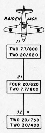

I believe it can choose to replace just 2 or 4*20mm cannon, as the title photo shows that J2M can still have 2* type 992 cannons, and according to the"Japanese Air Weapons And Tactics, 1947 (U.S. Strategic Bombing Survey) : Military Analysis Division : Free Download, Borrow, and Streaming : Internet Archive
2​
" at least we have J2M4 with 2*30 and 2*20mm version

I have searched for that, but it does not work. All the documents just mentioned We do have some J2M which are equipped type2/5 30mm cannon, but no details.
