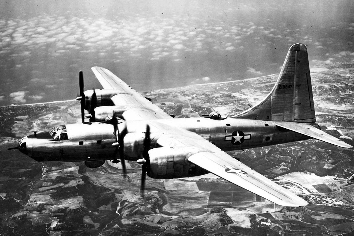

Much has been written about engine fires on B-29s powered by the Wright R3350. The B-19 and B-32 used the same engine but I've never seen anything written about engine fires on those aircraft. In particular, the B-32 cowl design was quite similar to that on the B-29. Does anyone have an explanation for that? Is it a case of little documentation, or less of an issue with those two aircraft?

From what I've read, the details of the engine installation were the source of the problems, coupled with the relative immaturity of the engines. The B-29 had turbochargers, while the Constellation and XB-19 didn't. Turbochargers run very hot.
The R-3350 engines may have been right on the border of cooling regardless of the turbo installation.
The few C-69s built had cooling problems. I don't know what Wright (and Boeing and Consolidated and Lockheed) did for baffling, propeller cuffs, changing in cylinder fins, Cylinder head fins and other things. but a 1948 commercial engine was not the same as a 1944 bomber engine.
I imagine the wartime bomber engines were pushed harder than airliner engines too.

My understanding is that there were also problems with the design of the exhaust system which had a separate forward located exhaust collector ring for the front row of cylinders, in front of the engine. That was because the cylinder exhaust ports faced forward. The rear row of cylinders had exhaust ports facing aft. This allowed extremely hot air to be blown directly on the front cylinders. In addition a cracked or damaged manifold would let flames direct hit them. The R-2800 was designed with all exhaust ports facing to the rear with pipes leading to a single collector ring behind the engine. The 3350 exhaust system was later redesigned in a similar fashion.
IIRC the ground crews used to frequently change the 3 or 4 cylinders that tended to overheat. I think these were lower but I dont know which bank

The reason the B29 engines had the problems was the front cylinders exhaust outlet was towards the front, the collector ring in the front allowed all that heat to be blown back to the engine.
That is the main reason for the now flying, B29 Fifi having non standard engines. No longer a hot exhaust collector sitting in front of the engine.
