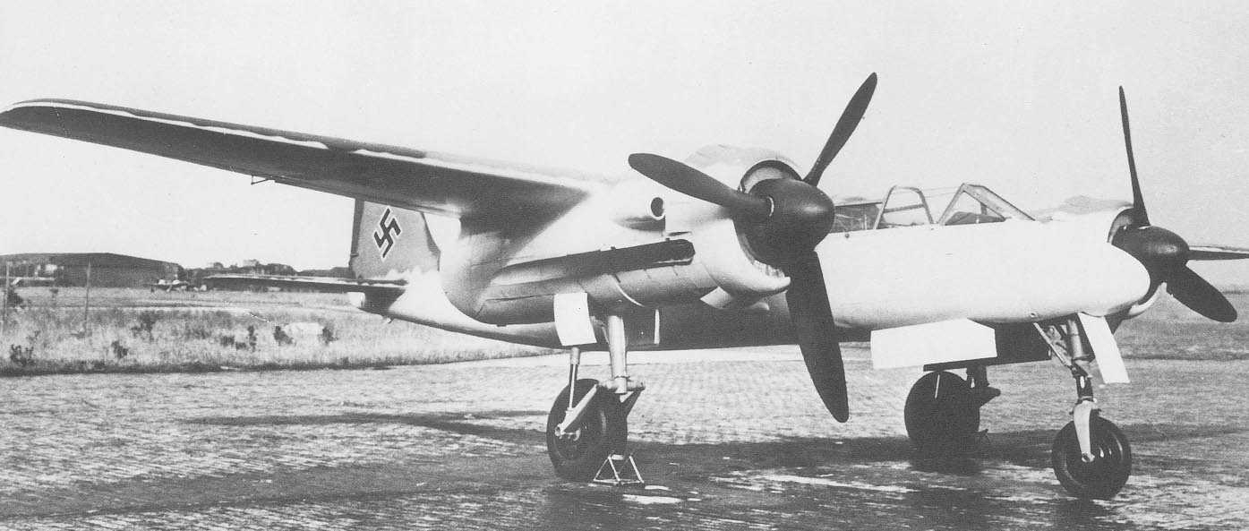

Now the question, I have little information on the ta 154 in my library as far as equipment is concerned, and I would like to see some photo or description of the equipment that the co-pilot was wearing in the lower right front part, as I show in the photo. The lace is dry to be able to focus the position and thus be able to paint it later...
Sorry but I have nothing of the Funker's office. Maybe use Kalakan's recent Me262B build as a reference.
I only have this pic of the Ta 154A-1 cockpit, probably not much use for you.
Source: 'German Aircraft Interiors 1935-1945 Vol.1' by Kenneth A. Merrick

Also I suggest getting a look at the thread ...
the source:
Best I could find Sergio, not much help I'm afraid
Caption says, Radio operator's position in the mock-up
the source:
Thank you all 3 for your help. It is difficult to see the position of the gunner/navigator/radio operator... I have looked for paper books for future consultations since today it cannot be... but in the search I found the video of d.s.m. about the detail of the cabin of the A0 version that was identical to the A1/R1 version, which is what I'm going to do... so I have a good reference to work with... when I get home I'll post it to you
