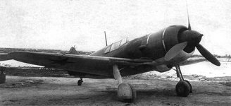

It was Mikhail Goudkov (Gudkov) who tried to install M-82 on the LaGG-3 in the early 1942 - I mentioned it already. No documents on transfer of the cowling design from Soukhoi (Sukhoi) to Goudkov have been found until now. The design of the Gu-82 cowling was a bit similar to the Su-2 one, but in no way exactly the same.
It's very well documented that Lavochkin and Gorbunov mated the engine/cowling from an Su-2 onto the front of a LaGG-3 airframe.
Prove otherwise.
I would appreciate any references to documents.
Prove otherwise.
It's the presence, not the absence, that needs to be proven. I have not seen anywhere any mention of _documents_ about transfer of drawings from Sukhoi to Lavochkin. What was written in popular literature was often just unsubstantiated opinion. It is enough to look at the cowlings of the La-5 and the Su-2 to realize that they are quite different.
The question was studied not so long ago by Gennady Serov, he failed to find in the archives any mention of the transfer of the drawings to Lavochkin. But he managed to find the name of an employee from the design bureau of Shvetsov, who helped Lavochkin a lot with the engine cowling. And the "design" itself was carried out on an urgent basis, often based on sketches, not official drawings.
Gorbunov did not design any new versions of the LaGG, unlike Gudkov. He suggested a project of a dive bomber which was never built.
It was GUDKOV who designed the Gu-82 with a Su-2 type cowling. Perhaps even using Sukhoi's drawings. But not Lavochkin or Gorbunov.
Gu-82:
Su-2 M-82:
LaGG-5:
