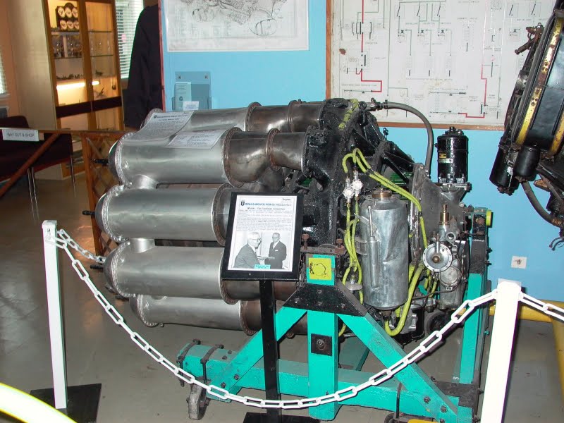

First run 1943. But AIUI in 1941 RR took over the Derwent project. So, in 1941, RR had four aero engines in production or development: Merlin, Griffon, Crecy and Derwent.
Eventually, in early 1943, Spencer Wilks of Rover met Hives and Hooker for a dinner at the Swan & Royal Hotel, Clitheroe. By mutual agreement between the Minister of Aircraft Production and the Boards of Rover and Rolls-Royce, the Rover jet factory at Barnoldswick was exchanged for the Rolls-Royce Meteor tank engine factory in Nottingham. A handshake sealed the deal.
There were 2 engines Rolls-Royce took over - the Wellend (W.2B/23) and Derwent (W.2B/26).
