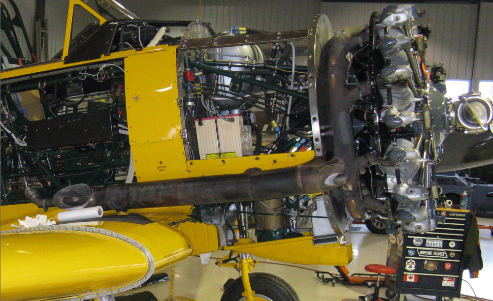

Post war the F4U-5 and T-28's had a separate gasoline powered heaters that could be used for cockpit heat as well.
T-28 heater exhaust, small hole with stainless steel panel just above wing leading edge where it joins the fuselage. https://render.fineartamerica.com/i.../mediumlarge/1/jive-trojan-822-grady-lisk.jpg
oh yes - if engine installation was wrongly designed - in a case of of La-5 and La-7 cockpit was nicely heated up to 50C not mentioning of "interesting" presence of the carbon oxide inside as well. It was enough to force Soviet pilots to permanently fly with open cockpits.
