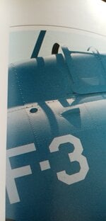

Dear All,
I very appreciate some help with two F4F-4 technical issue that I am not able to identify properly. This is small airscoop on the right side behind the cockpit, respectively opened canopy, plus small round opening/hole (unknown purpose for me) in close area and located slightly higher then airscoop but within one fuselage segment.
Both feature was not intruduced on F4F-3 or 3A with the exception of last production run of 100 planes that was built in spring 1943 after ceasing production of F4F-4 serie at Grumman factory.
Many pictures of F4F-4 show this both feature but not every ones, unfortunately. It seems that this both feature was introduced gradually somewhere during second production run (BN 5030 – 5262) in early Spring of 1942, i.e. not from the beginning. Several pictures show F4F-4 without airscoop as well as round hole (aproximately till Guadalcanal campaign), some only with the round hole and mostly ones with both feature.
For example – picture of white 10 of VF-3 (BN 5149) from Midway or black 41-F-8 of VF-41 (BN 4084) from April 1942 clearly show planes without any of a/m features.
On the contrary, F4F-4 black 13 of VF-6 (BN 5193) from the beginning of Guadalcanal campaign has only round opening/hole and no unit-marked F4F-4 of BN 5262 (served for testing of new system od double flaps) as last machine od second production run has already both fearures,

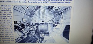

Dear All,
This si very interesting picture of fuselage interier heading towards to the cocpit. We can see some kind of tube with collar for connecting of something in position of hole/opening (right upper corner). Cooling opening covered with airscoope on the fuselage surface is directly behind and bellow the tube as on aircraft.
I can fully imagine that flare discharger may be attached the visible tube.

Dear All,
Note that the five holes in the plate shown in your photo, as well as the offset of the tube, perfectly match the illustration of the Molin projector previously show, bolts and all.

I have seen the hole for the AN/M-5 flare discharger on some F4F-3 airframes also, though I do not know if it was from the factory or a field modification.
Edit: The last 100x F4F-3 (Bu.No.12230-12329) had them fitted on the production line, these being the last F4F airframes produced at Grumman.

last 100 planes of F4F-3 manufactured in the Spring 1943 after ceasing F4F-4 production had this modification including airscoop on fuselage. This late F4F-3 had virtually F4F-4 fuselage with nonfolding wings, old style of pitot tube and was intended only for training duty. Confirmed by several pictures.
I believe that the flare set up was original and have pics of VMO-251 F4F-3P (BuNo 1855) and F4F-3 (BuNo 1890) with the opening, but no aux air scoop. This would indicate that the first production batch of F4F-3s had them and if i have time, I will pull out my copy of original Grumman bleuprints to see if it is indicated.
