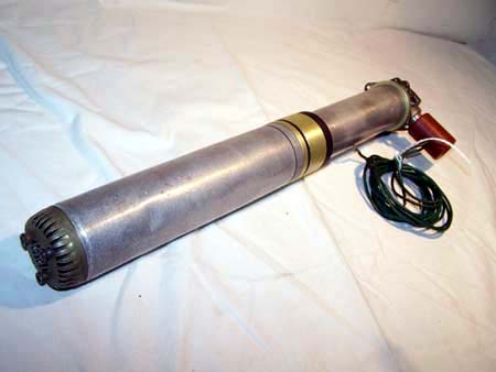

Hi all:
Data plate with the following data:
Bauart: DBU Berlin;
8-88813 03;
T = 235;
Werk No. 3261;
Hersteller DBU Gerätebau St (illeg) wig.
Definitely a boost pump or fuel level sender, the T-235 is the length.
Like the others, I'd go with a fuel boost pump...
