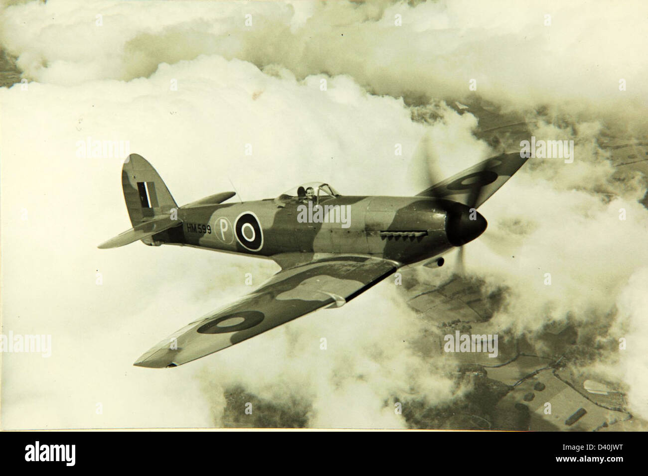

Some solutions are just 'right'
That is a late solution to a problem that was fixed.
Thats a logical development of the Spitfire like MB3 and 4 to reduce the high drag from underwings radiators - as per the P-51, that design utilises the Meredith Effect to improve cooling, significantly reduce drag and actually gain some thrust.

Germany and UK had jets in squadron service in June 1944. The MB 5 flew the month before for the first time, it was too late or everything.
Depends on the judge? The judges at De Havilland and Hawker judged affirmatively wrt. the LE radiators.
Yes, I'm aware of those. I guess my question is more of a theoretical nature. What is the aerodynamics of a wing with LE radiators? And given they are such an obvious idea that even yours truly can imagine them being a good design, why didn't world+dog adopt them?
The wing leading edge needs to have enough volume to hold the whole cooling system. The Mosquito was a bomber not a fighter and the engines were changed to allow the installation (water flow was reversed). On the Hawker Sea Fury the LE radiators were cooling the oil, the engine was air cooled.
