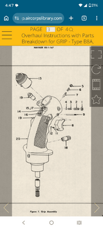

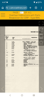

Item numbers 5, 6 and 7 in the drawing. You can clearly see the slot on the adjustment barrel on all the pics above. This was there to adjust trigger tension with a flat blade screwdriver. The barrel is metal, as plastic would not be durable enough.
Hi Tex, it's not the grip of P-47. Thank's.
