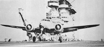

That beats my candidate:
The XJO-3 (one of 3 Lockheed Model 12 Electra Juniors modified with tricycle landing gear) was delivered to the USN on 15 October 1938. It was an experimental aircraft intended to test the feasibility of using (1) twin-engined aircraft and (2) aircraft with a tricycle landing gear on an aircraft carrier. On 30 August 1939, the XJO-3 made eleven landings and takeoffs from the USS Lexington (CV-2) off the coast of California demonstrating the basic adaptability of this type of aircraft to carrier operations.
