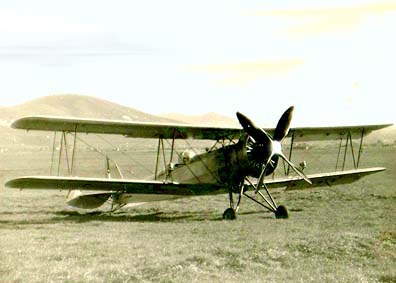

Greetings all, I am trying to get some information regarding this specific engine. Specifically, in which way it was modified for the altitude record-setting flight in 1937 with Lt. Colonel Pezzi at the controls.
Any ideas? Thanks in advance.

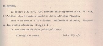

From original handbook
Thanks for these interesting papers !
Translation of the most important passages
Compression ratio 8
Normal rpm 2400 per minute
Normal ground power 550 hp
Normal power at rated altitude 700 hp
Normal rated altitude 10,000 m.
In order to allow maximum lightness, the entire engine crankcase is made of forged duralumin, while the gearbox casing, the timing cover, the compressor body and the auxiliary controls casing are cast in electron.
The essential feature of the P.XI.RC.100 engine is the compressor unit, of the two-stage type, with fans keyed onto the same axis rotating at the same number of revolutions, with a ratio of 8.4:1.
A special, single-body carburettor is mounted between the first and second stages.
Too bad the text is interrupted on the question of high altitude ignition.
