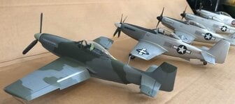

Here are the 1/48 scale Light Weight Mustangs that I have spent the last few months on. In the foreground is FR409, the RAF XP-51F, then a XP-51J, two examples of the first XP-51G, then the RAF FR410 XP-51G. Note that both XP-51Gs ended up with the early P-51H (short) tail and the 4-bladed prop. The XP-51Js both presumably had the P-51H tail although I have no information about the second XP-51J. These models were built from the 1/48 Modelsvit P-51H, my second generation canopy, and a lot of milliput. I added the fuselage section below the windscreen to my latest canopy vacuform and that made things much, much easier this time! If I did it again, I might try attaching a P-51D upper to a P-51H lower, but in 1/48 scale it might prove to be a real hassle to match them up.

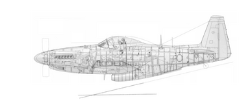

I suppose it makes sense to go chronologically, so here's the comparison of the P-51D and XP-51G. I'm skipping the F model because I don't have a reliable drawing for it and it's pretty easy to point out the difference between the F and G models.
What you can see here is:
1. The upper profile of the D and F/G were nearly the same (other than the canopy)
2. The lower cowling lines were nearly the same (except that the F/G carb intakes were set a little further back and were not vertical)
3. The entire ventral duct was more streamlined for the F/G (not shown is that the F intake started at about the same location as the D)
4. The leading edge of the vertical stabilizer was more upright on the F/G
5. The F/G had the big canopy, of course.
6. The pilot seat was higher in the F/G but pretty much the same location fore/aft
Not shown is that the whole tailwheel assembly was moved further aft for the F/G, but that is obvious in photos.
It's not really visible in this comparison, but the vertical fin tip was more rounded on the F/G.
Also not seen in this comparison is that not all P-51D aircraft had dorsal fins and the F/G models either didn't have them or they were smaller.
The early P-51s used the wing upper surface for the cockpit floor. The P-51D had a plywood floor added on top of that, but the floor was still so close to the wing that the wing tank fuel gauges could still be viewed by the pilot. Starting with the XP-51F, the floor was raised something like 7" (anybody have an accurate figure?) and there was some rather interesting equipment below the floor. This is not easily visible in the comparsion shown here.

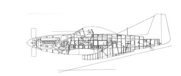

Here's the XP-51G general arrangement drawing by itself.
Key features to note are:
1. raised cockpit floor with the gas-fired Janitrol heater below the pilot's seat. Right above the main fuel tank. No wonder pilots were concerned about this!
2. the pilot seat was hydraulically raised/lowered (vertical the red bar). The horizontal green bar represents the follower links. As the seat was raised, it naturally pushed back a bit.
3. the curved shape of the vertical fin tip is easier to see in this drawing.
4. the upper longeron is horizontal in front, but behind the pilot it is diagonal (by the amount the floor was raised, it appears)
I forgot to mention that the firewall of the early Mustangs (NA-73X thru P-51D/K) was more angled than the later Mustangs (F/G/J/H), which were more upright.
The firewalls themselves were basically flat, but if you look closely at the LW Mustangs (F/G/J) from the outside, you will see that the firewall panel line seems to go vertical at the top. That is just the outer sheetmetal that fits under the windscreen that is vertical. If you remove that fairing, you will see an angled firewall underneath.

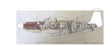

After the XP-51G, you need to proceed to the XP-51J. Even though it had a totally different engine installation, it is a necessary steppingstone to get to the P-51H.
This is because they added an extra fuselage frame at the very end that moved the rudder hinge line further aft. They also greatly enlarged the vertical tail. These features were inherited by the P-51H. Or maybe the J inherited them from the H? I don't know. They were developing all of these Mustang variants, including the P-51D, somewhat concurrently. The contract for the XP-51D (NA-106) came AFTER the contract for the XP-51F (NA-105), after all. There was a war going on and priorities could change at any time.
This comparison between the XP-51G and XP-51J shows:
1. the engine installations and cowlings were very different, but the firewall locations were the same
2. aft of the firewalls they were pretty much the same until you get to the tail
3. they added an extra fuselage frame that was approx. 5" long which pushed the rudder hinge line back. The vertical line is the J rudder hinge line. The G rudder hinge line is not shown but you can see how the supporting structure is further forward for the G.
4. the leading edge of the vertical tail is even more upright than before on the J
5. The difference in length between the G and J is split between the cowling and tail. Keep in mind that these comparisons are anchored at the wing spar.

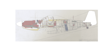

Although the XP-51J had more in common with the P-51H than any other model from the firewall back, the Allison engine installation made it a bit of an odd duck.
The XP-51J general arrangement drawing shows some notable features:
1. the 2-stage Allison engine installation took up a bit more space than the Merlin installation and the structure was completely different
2. the carb inlet moved to the ventral duct tunnel so the incoming air had to pass through a large rectangular passage under the cockpit floor
3. the Janitrol cockpit heater had to move somewhere and this is not visible in the drawing, but it was tucked under the starboard belly of the Allison engine. Kind of like the stbd engine bay machine gun in an early Allison Mustang. The Allison engine didn't need that space, unlike the Merlin. This seems like a much better location for a heater, gas-fired or not.
4. there was a great big hole in the firewall where the inlet for the 2nd-stage supercharger was located

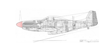

The last step of the journey (ignoring the Twin Mustang, of course) is to go from the XP-51J to the P-51H.
I do not have a good factory drawing of a P-51H. You would think those would be easier to come by. So I used the drawing from the 1/48 Modelsvit P-51H, which is excellent.
I think it is a pretty accurate drawing, based on staring at it and photos of P-51Hs for a few years, now!
Comparing the XP-51J and P-51H drawings, you see that:
1. the ventral ducting is the same
2. the vertical tails are the same, accounting for the fact that the Modelsvit drawing is of the production tall tail rather than the initial short tail
3. the upper back of the P-51H is raised, so the dorsal fin also had to be raised
4. the firewall was pushed forward on the P-51H by approximately 12". Remember that I am referencing everything to the main wing spar.
5. the cowling was raised in back and flattened out on the P-51H
6. the cowling was a few inches shorter on the P-51H, so the spinner is not a full 12" further forward (it's closer to 8-9")
7. the bubble canopy was reduced in size to be more like a P-51D. Blown canopies were a new technology at this time and the LW Mustang bubble canopies were actually made of two parts glued together. If you look closely in some of the better photos, you can see the joint!
My real interest in all this was originally just to build models of the XP-51G and J. Based on these comparisons, I do think the most straightforward way to build a XP-51G is to take the top of a P-51D fuselage and the bottom of a P-51H fuselage and glue them together. This is, of course, easier said than done. I'm trying that right now and it is certainly difficult to line things up properly. However, I have also tried starting with a P-51H and then modifying the upper deck and that's pretty hard, too. So like folks have said previously, there's no easy way out! Doesn't mean it can't be done, it's just another challenge!
Here's the approach I am taking on the G (first photo). Shorten the P-51H, then graft on the top of the P-51D. The 1/48 Tamiya Mustang has a one-piece top cowling so it is a pretty good candidate. I just hate to cut up a good kit like that if I can avoid it, so I used an old Monogram P-51D. It's cheap, but not such a great choice because it is now THREE pieces you have to attach (the nose is separate).
Still, I think I would take the same approach on a 1/72 model. Here's how the 1/72 RS Models P-51H and recent Airfix P-51D stack up. Please ignore the drawing in this second photo. I made that before I got my hands on the XP-51G general arrangement drawing and this isn't quite right (cowling is too short and tail is too long, by several full-scale inches).
