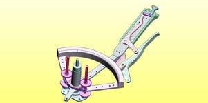

Nice work, straight away looking at that you can see everything is correctly scaled and proportioned, very difficult to achieve from the few images i previously had none of which showed any detail especially of the rear side like the ones you posted here. Still very wip but will post more images after making changes. Spits would you be kind enough to post or send me a side and front profile of your model so i can check the scale? Regards

Bottom part is pretty basic,almost like a WW1 throttle.The handle itself holds the gun selector and in front of that the trigger..The diam of the main quadrant is 185mm.Im having drama getting into proper CAD layout so it reads flat..
Thanks Spits, really appreciate your help.
