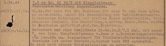

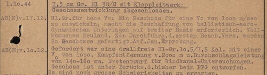

Different ways to square the circle of the HEAT shells not being that good when firing from the rifled guns. One approach involved the introduction of the shell that has the expandable fins (Klappleitwerk in the doc below); the development is finished (with what results - it does not say). The way of avoiding the rotation by the rifling must be found (drallfreie = non-rotatting). Another thing that was mooted was the very high MV for the HEAT ammo, 1000 m/s; that is commented as being the 'uncharted territory' (Vollkommenes Neuland). A way to have that from the 105mm howitzer was supposed to be the under-calibre (10,5/7,5 Kal.) shell with discarding sabot (TS).
The last sentence says that big problems (grosse Schwerigheiten) still lay ahead.
I have a personal problem with HEAT shells in WW II.
Even in the 4-5 years of WW II there was a lot progress made in the design of HEAT Shells and fuses. There seems to have been a lot more made between 1945 and the mid 50s. Let alone what was done from the late 50s onward.
WW II showed it would work but not a lot more without development. Which it got as the small AT guns (Under 90mm in the west) could not really deal with the Soviet boogie man (JS III) unless very very close and using Tungsten Carbide. HEAT was the only avenue for AT weapons that were less that 3.5-4 tons and WW II had shown that those were not actually usable as towed AT guns. A lot of recoilless rifles in the late 40s and 1950s. A lot of Primitive wire guided AT Missiles.
British gave up on HEAT during WW II as you know and never came back to it (unless in the last 10-15years, I haven't been paying attention).
Expanding (flip) fins didn't work well in low pressure mortars. I would guess they would work even less well in a high pressure gun barrel. Or even in a moderate pressure gun barrel. The idea has merit, the execution has problems, any problems with the fins or any problem with uneven/unequal timing on the expansion of the fins means a miss at medium/ long range. The Americans used slipping rotating bands to cut down on the RPS of the shell. French in their 105mm tank guns tried putting an inner shell inside the rotating outer shell separated by ball bearings. They accepted a smaller diameter shaped charge that was not spinning much rather than a larger cone that was spinning. Maybe someone has the specs, I don't. A lot of the low pressure 90mm guns of the 50s and 60s used shaped charges and fin stabilization but their materials and research ( high speed cameras, wind tunnels, etc) was better than what could be done in WW II.
Trying to use high velocity HEAT rounds means you need really, really, really good fuses. Most (all?) modern HEAT ammo uses a longer stand off distance the WW II. Higher impact velocity means less time for the fuse to function and more crush to the nose cone (less stand off distance). But slow shells have problems hitting. Firing a 75mm shaped charge out of a 105mm barrel means you have to deal with spin, you have to deal with inaccuracy due the discarding sabot/s and you now have a small diameter shaped charge cone. They had to find out what did not work in order to concentrate on what did.
We have hindsight, we have a much better understanding of what didn't work and why.
HEAT ammo was somewhat effective from smaller guns (75mm and bigger) against light (maybe medium? ) tanks.
Trying to fire something the size of the German Stick bombs (145mm to 160mm or inner diameter and outer?) that weighed 8.6kg with 2.43kg of HE at even 400ms is going to be quite a trick and require a weapon larger than a 10.5 cm howitzer. And the 180mm penetration is at 0 degrees. Things got a lot better in the 50s, 320-360mm penetration from 90mm shells of much less weight, but that requires time travel.

And we are back to using 1960s technology (aerodynamics, HEAT warheads, and manufacturing) to say what people could have done in 1943-44.
The execution was from the 1960s.
The idea and experimenting with different shells that had the slip rings and pop-out fins is German from ww2. They made much more of the experiments on the long HE thin-walled shells for the 'normal' artillery, that had the slip rings and pop-out fins; these also looked a bit different, with fins extending backwards.
Slip ring is the 'Drehb. Fuerungsring'.
