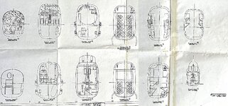

This is the factory data for all the bulkheads for the B-25A though to the B-25G. The B-25H & J had the horizontal stabilizer raised 7", with the corresponding changes to the rear bulkheads and their widening starting at Station 558.75 for the tail turret installation. The attached book is the best for correct factory data.

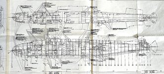

Not part of this thread but just to add it as a note: the different ("fat") fuselage of H/J model starts changing @ station 304. Between stations 70 and 304 ALL B-25 variants and blocks are the same. The 7" difference in the depth, quoted by many authors and modellers, should be at station 490.5. I couldn't verify the latter statement but as per the above drawing (Fuselage Ordinates) the height of the earlier B-25 & station 490.5 is 59.12". BTW Norm Avery has simplified ordinates-tables on page 160 in the above mentioned book ("The B-25 Bible").
Years ago I did a comparison between B-25B/C/D/G and B-25H/J fuselages, using some simplified drawings from Avery's book. Never came to the "mythic" 7" difference (see below my dimensions @ 490.5; 59.12" is rounded by AutoCAD to 59 1/4"). Of course using scans of prints of copies of....I don't know what, is never the best way to find the truth. Maybe the 7"-difference is at a different station?
Later started a complete new drawing based on the above table and ordinates but didn't finish it. It's never too late though...
Cheers!
Norm "Jim" Avery was a draftsman for NAA in WWII. He was the father of a good friend and gave me copies of many blueprints, including these.
You are blessed!
Thanks for the drawings - I'll try to put the side view/section of the J in scale and check that difference again.
