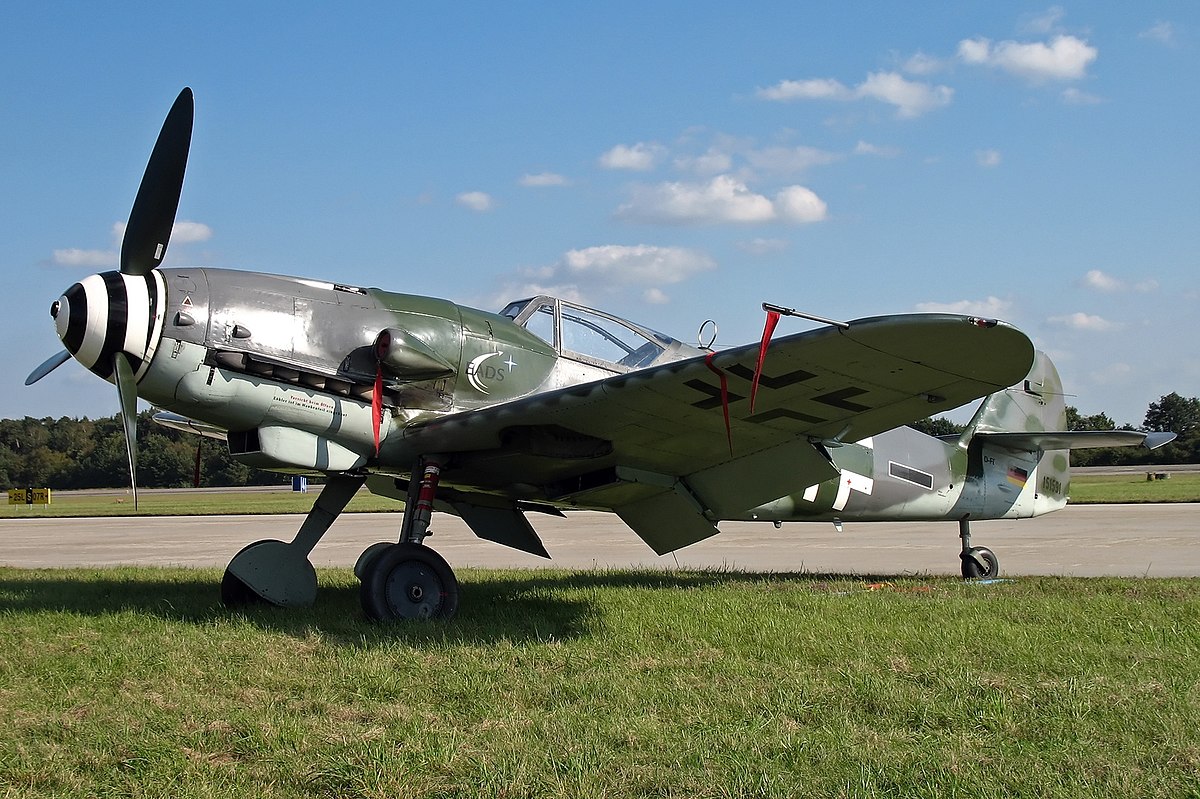

Those are not E models. This pic is from an E manual found on this site. The bomb panel might indicate an E-7 or retrofitted earlier model. I don't think I see any fuel lines there.
