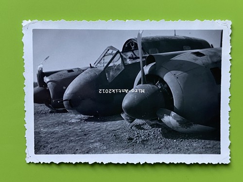

nose detail

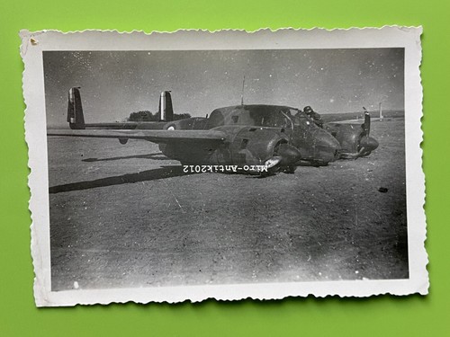

Post # 22 and 23 seem to show same Breguet 691 as #7 ... but a bit earlier (see rudder !).

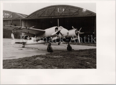

And a QUIZZ ..... : post #22 clearly shows a very special similarity between Breguet 691/693 and P-38 Lighting... Do you see it?
Handed engines rotating propellers to the outside?
Yes. Propellers in counter-rotating twins (which was the case for all French aircraft in 1939) are generally supra-convergent, except for the Breguet 691/693. This was also the case with the Lockheed P-38. For the P-38, this improved tailplane efficiency and stability. For the 691/693, I don't know....

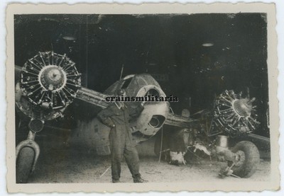

beute captured

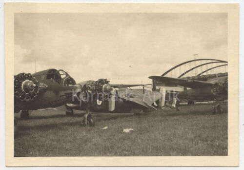

From left to right : Breguet 695 (Pratt & Whitney engines) , LeO 451 tailplane, Breguet 69x (can't see the engines...). Maybe a 695 too, rudders seem high.

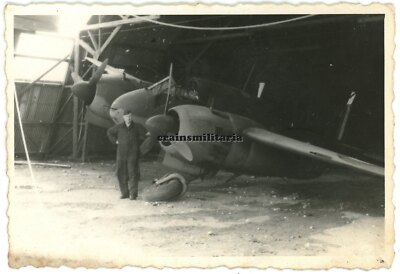

Hangar collapsed wheel captured beute
A frequent breakdown, the Breguet 693's magnesium landing gear was fragile
