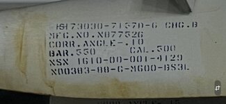

Can anyone help me find out what plane these blades went on? Bought a crate with 3 blades are still in cosmoline and have the paperwork and bearings.
Sorry I can not find an aircraft that it goes on. It is a Hamilton Standard blade model 7157D-6. It has an "NSN" number when searched matches the blade model. The "N00383" number I can not find it, but believe it may be a US military supply system number.
The "7157" model is later than any other blades found in the Hamilton Standard commercial blade overhaul manual date from 1980.
I should have asked what is the length of the blade? Do you have an image of the blade butt end and the entire blade?
