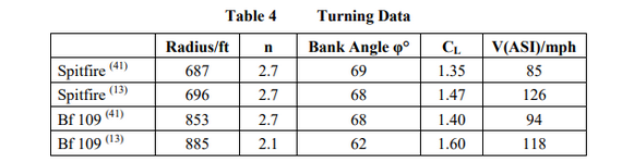

A few words from a guy who spends too much time playing video games and recognizes certain kinds of posts by people who also do the same thing.
1. When it comes to performing simulations like this it is important to have correct CL/CD curves and have them as a function of speed. This in and of itself can be a process that is very difficult in its own right. Getting the CL/CD curves slightly wrong in either direction will skew a simulation like this.
2. This pre-occupation with the Bf.109 being able to use flaps to turn the tables in a dogfight seems to be something of an obsession amongst the videogame crowd from games like IL-2 and War Thunder.
3. Of the popular video games, War Thunder probably models this interaction the most accurately. Flaps usage on the Bf.109 E-4 will reduce the turning radius and increase the turning rate by about the margins that are presented in the original post here. The difference in overall conclusion though is due to the fact that OP predicts sustained turn rate figures that are slightly more favorable to the Bf.109 E-4 than what is modeled in War Thunder. The difference is about 1 degree per second.
4. The other point of comparison that I can make is with IL-2 Great Battles but there isn't a program to analyze the flight models available for it. My impression of IL-2 after playing if for about a week is that the flight modeling is even more jank than War Thunder and that the margin of advantage for some planes in that game is much larger. I would suspect that the Bf.109 E-4 vs Spitfire I dogfight in that game is a more one sided affair than War Thunder.
5. Amongst people that do a lot of 1v1 fights in these video games this conversation has come up in the past. One of the things to understand is that the flaps on the Bf.109 are basically on a hand-wheel and they can drop to around 42 degrees. What is being modeled here is the turning radius of the plane with about 60% of its total flaps deployed; this is a fairly slow process and not necessarily something you would want to be vigorously doing in combat. This is one of the things that both of the videogames do not necessarily model well because you can just set flaps to a button and just hold it down.
6. The other issue about the videogame stuff is that there are more people that have some general awareness of energy maneuverability theory in ways that World War II pilots were only vaguely familiar with. There are also just some things that you can do in the videogames that would not necessarily work in real life. It is very easy to fall into this thinking trap that just because it works in real life that it will work in the video game and vice versa. Unfortunately I often times see instances of both when it comes to commonly available content.
3. Of the popular video games, War Thunder probably models this interaction the most accurately. Flaps usage on the Bf.109 E-4 will reduce the turning radius and increase the turning rate by about the margins that are presented in the original post here. The difference in overall conclusion though is due to the fact that OP predicts sustained turn rate figures that are slightly more favorable to the Bf.109 E-4 than what is modeled in War Thunder. The difference is about 1 degree per second.View attachment 885933
1) Absolutely. And in my simulation model, Clmax is a function of Mach, so the faster you go the lower will be the aircraft's Clmax. The same goes for drag: At about M=0.5 you need to take drag creep into account or your results will be too optimistic. Same goes for propeller efficiency, which needs to be modeled due to both blade loading and Mach.
2) Il-2 had a way to optimistic flap model earlier on. Especially Russian fighters were generously modeled. Maybe that is still the case? I don't frequent their forum much though these days. Why (that they had modeled quad drone with RPG Warhead) is clear from my last posts in their old forum which they've now closed down.
3) SEP based climb rate is really only valid for small climb angles, i.e. when the lift vector is almost vertical, which is not the case for WW2 warbirds. Same goes for turn estimates. If you don't take into account that the engines thrust axis is not aligned to the speed axis, yours estimate will be a bit conservative, and which is why my estimates are higher.
4) Yes, the turn rate accuracy in IL-2 varies: Years ago we were a few people who spent time painstakingly logging in game turn times. For example, the Bf 109 G2 there is quite conservatively modeled while the Yak-1 is either spot on or a a bit on the optimistic side. In addition, the turn times at higher altitudes in IL-2 for German fighters was far worse than physics would indicate.
5) Yes and no: When entering a turn fight you would probably extend the flaps only gradually anyway as the speed wound down, so if it took a bit of time was probably not an issue. However, sure, after you succeeded in out-turning your opponent, it would take time to extract them. But still, Marseille used flaps, so it was done.
6) Yes, some virtual pilots have amassed thousands of hours expending countless virtual lives to figure out what works and what doesn't. In addition, some games flight models at lower speeds are ludicrous with all manner of maneuvering with full flaps and gear out being done in a post stall environment. In addition, people complain that guns are too accurate. But in general they are not. The problem is that with thousands of hours deflection shooting in game, you have an experience base IRL pilots can only dream off.
