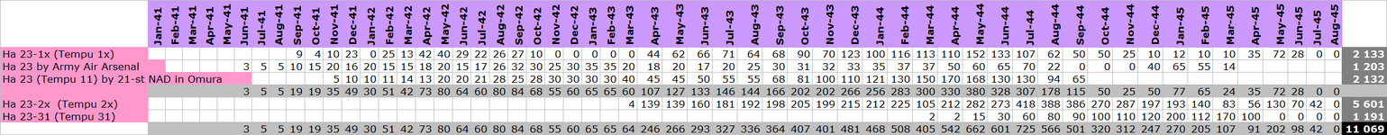

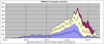

Continue... Here are 2 screenshots of the Japanese engine table. I found them a long time ago on some website. I remember that this data is from a book.
There are both HA13 and 13a here. In 1 screenshot. But they have a different capacity specified. And here, the Tenpu 11 engine is not specified anywhere. But here, in the 2nd screenshot, there is a Hitachi GK2 TEMPU. In short, a confusing story ...

Good afternoon, everyone! Dear Shinpachi, I found the site where my screenshots were taken https://military-history .fandom.com/wiki/Japanese_aircraft_engine_identification_systems?veaction=edit. Here's another photo. Could you translate it? But judging by your data, all engines are not suitable for power, namely 300 hp. In this case, tell me where to find the correct technical data for both the engine and the e14Y1 aircraft. Maybe this progenitor of the Amakaze 21 engine for K5Y3 is Tenpu 11?

I am very sorry, dear Shinpachi, that you cannot continue our research. But I, under your strict guidance...), started this discussion, and I will have to finish it. I took 2 screenshots from one book. The quality is poor, but a lot can be understood. You wrote that you had not heard of these names 1 瑞風 (Hatakase), 2 陣風 (Jimpu) and 3父父 (Tempu) for Hitachi/Gasuden engines. They are present here, both in the first picture and in the second. On the second one, fortunately for me, I found which aircraft were equipped with certain engines. Now I know that the Amakaze GK2 engine (the manufacturer's G-code is Hitachi and the letter K- air-cooled engines were designated) with the designation Ha-22, were installed on E14Y,K3M2,K5Y,K11W,Q1W aircraft. There is also a designation for army engines and airplanes, but I'm not interested in that right now... Maybe someone will need these 2 pictures, I was glad to help. Good luck.
Yes, I almost forgot...In the top post, these are screenshots from the book by Mawhinney, Robert. Japanese Aircraft Engines. Washington D.C.: NASM.
And these 2 pictures are from the book Japanese Aero-Engines, Mike Goodwin. Now that's it...)
