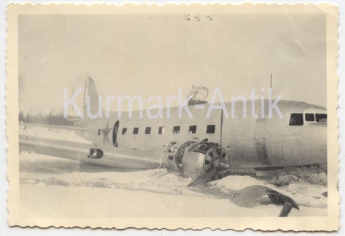

Didnt know the soviets put turrets on c-47.
That's true that the top turred was something rare on the C47. But some of them got them as the PS-84/Li-2.
the source: C-47 in Soviet service
Additionally there are the differences between the DC-3/C-47 and the PS-84/Li-2. Omitting the engine types, the main differences were ...
the Lisunov kite had the cargo door open up while the USA plane had the door as the two-part one sideways open. This can be notice in your pic above. What is more, the PS-84/Li-2 kites didn't have the astro nav cupola at the fuselage top behind the pilot cockpit. The one in the pic has it. And the next difference .. the main landing gear rear struts. Both the DC-3/C-47 planes and the licenced russian passenger PS-84 had them of the cradle type with a single support at the rear. In the 1942 when the cargo PS-84 variant named Li-2 appeared, the soviets modified the rear support with the two struts there. The cradle single stick support can be noticed slightly above the starboard light of the truck. About the rectangular window glasses with the rings in I don't mention .
the source: Li-2 camo evolution
Looks like they used the place for the nav dome to mount the RDF loop.
Actually they had never the Astro dome there. And yes, it was the the radio-compass antenna in the fairing there. Depending on the aicraft series it could be: RPK-2 (RPK-20), RPKO-2A, RPKO-2B (RPK-2M). After the war the Li-2 got the APK-5 as memo serves.
