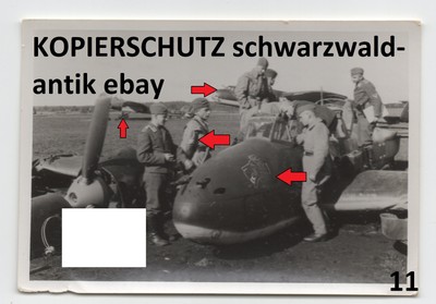

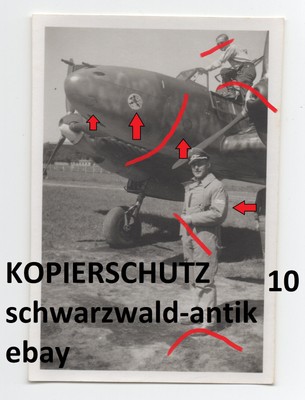

Thanks John. What made it come down? And was it a total or less? . I would think 40 % or so. Guns already taken out so with i german borders i think.
I honestly don't have the answer to this one. Both the Luftwaffe Quartermaster Returns for damaged/lost aircraft, and the Namentliche Verlustmeldungen (for personnel losses, which included aircraft details) show only 3 S9+GPs, two for June 1941, the other for June 1942.
Now, take a look at THESE photos. Yep, it's the same aircraft - that is definite simply by checking the camo on the starboard side. BUT, which photo came first? The one in the snow, meaning that the aircraft was left in situ for a considerable time, or the one in 'normal' time, left in situ until winter time? What is even more of a puzzle is that the canopy in the snow photo is far more intact than in the non-snow photo, which would tend to indicate that it came to earth in winter!
And here's port side view, again with the centre & forward canopy section looking in decent condition.
Grrrrr! I'll see if I can find other sources tomorrow. 15 victory bars on the fin might give an indication of who flew it, at least!
