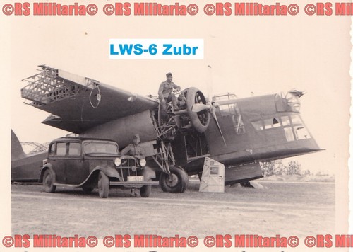

Unfortunately that's not the cockpit of the LWS-6 Żubr. IMHO it is of the PZL 37 Łoś. For these who would be interestied ... the fuselge of the LWS-6 was the space truss welded of the metal pipes and skinned with the fabric mostly. The space frame was of the square/rectangular shape in the cross-section rounded at the top and bottom. Here we may notice the metal oval structure with the bulkheads and stringers and metal plate skin. The Żubr had the cockpit and its hood displaced to the port side. The one in the pic is located along the central axis symmetrically. Generally it may be noticed the "glass nose" of the plane in the pic is very streamlined while the LWS-6 wasn't a such one.
Unfortunately that's not the cockpit of the LWS-6 Żubr. This is of the PZL 37 Łoś. For these who would be interestied ... the fuselge of the LWS-6 was the space truss welded of the metal pipes and skinned with the fabric mostly. The space frame was of the square/rectangular shape in the cross-section rounded at the top and bottom. Here we may notice the metal oval structure with the bulkheads and stringers and metal plate skin. The Żubr had the cockpit and its hood displaced to the port side. The one in the pic is located along the central axis symmetrically. Generally it may be noticed the "glass nose" of the plane in the pic is very streamlined while the LWS-6 wasn't a such one.
Thank you. Great info!
