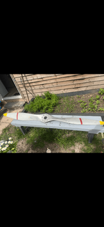

I have got a fairey reed propeller and wondered if anyone could identify it for me.
It's 7 feet long with yellow tips and a red stripe.
It has the fairey reed logo.
The number on the side is FR35860

Regarding your request .. the FR35860 is the prop serial number. There should be also the drawing ( DWG or DRG ) one stamped somewhere there. Also a pic of the prop could be useful.

I did add a photo but it didn't attach. I also can't see any other numbers on it I will check again.

OK. THX for the image. If memory serves these props were used for a couple of aircraft. For instance the De Havilland Moth series, DHC-1 Chipmunk and a few more.

Thankyou for your reply I will check tomorrow if there are any other numbers on it
No problemo. Take your time. Judging by the painting of the prop I would say it was used with a post war plane rather.

PS. IMHO it may be problem with finding of more numbers stamped there. There is a lack of a two-part boss where the info was engraved usually. Anyway .. according to my notes I made when we were indentifying another Fairey Reed prop here on the forum the 84 inch in diameter props were used with the De Havilland Gipsy Major and Gipsy VI engines. This may indicate the De Havilland Moth series, DHC-1 Chipmunk as I already mentioned it above, Also it could be used for the Gipsy Queen III power unit for the DH98 Dragon Rapide and possible the Avro Anson. I'm afraid it may be all what can be found for the kind of the propeller. But please check on the thread frequently because there may be somebody who can come with a more conclusive answer .
Please also make sure when you sell on that you underline the fact that the propeller is not airworthy!
