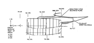

Theoretically, to gain 22kN thrust but don't have such a large engine, we could try to merge 3 JT8D engine PODs with 78kN takeoff thrust with less engine technology, producing a takeoff thrust of 234kN, almost the same with CF6, but is obviously less economical, consuming about 33% more fuel, with a range drop of 25% as approximately calculated.

concept application: DC-10-10 twin for low-bypass gravel runway kit:
For Thrust reverser of the 3-engine pod, it came with a difficult problem, to maintain the thrust-reverse capability.
But reversing the heat in the front of the wing causes the heat at a temperature of 200 Centigrades, would do harm to the structure of large planes in the long term, causing a great economical loss, but JT8D bypass ratio is relatively small so that the thrust reverser couldn't rely on the cold flow of the engine to gain enough reverse thrust.
So I came with an idea, that use an extra large airbrake on the engine cowl, to replace the thrust reverser of JT8D for tri-engine pod used on large planes.
It's roughly calculated that the extra-large airbrakes are 3m width * 1m height, and lie on the side of the engine cowlings, with a hole at the root of the airbrake to reduce the danger of structural failure and gain more stability.
Special: The airbrakes are extended foward-swept, but they're not fixed at the end of the engine, but conncted at the head of the engine, to give the airbreak enough stability so that the foward-swept high-efficient airbrake would automatically close once the hydraulic of the airbrake system fails.
Performance: a pair of such large engine cowl airbrake would produces more than 20kN reverse thrust each while the airspeed is greater than 75 knots and the airbrakes fully opened.
For the tri-engine pod, the upper engines use a pair of airbrakes, the 2nd engine down uses DC-8 style combined thrust reverser.

this is theoretical exercise of course - in my opinion configuration of engines pods shown on drawing except of presenting excessive interference drag is difficult / impossible to push through certification process
for such arrangement you have to use separate clamshell door type TR operating on mixed flow - because of bypass ratio of the JT8D engine cold flow TR performance may be close to hopeless
Thanks for your advise, for such an annoying tech problem, I came up with a new idea, to replace the thrust reverser of the tri-pod JT8D to solve the annoying problem of heat flow reverser of JT8D which might effect the life of structures, especially when the wing-mounted jets are crowdedly designed, producing similar reverse thrust when at an airspeed >80knots.
View attachment 672852View attachment 672853
this solution is structurally inefficient - your airbrake and supporting structure will carry plenty of unneeded weight. What is the reason for tri old inefficient low bypass ratio engine installation instead single turbofan? just for fun? :D Such arrangement is inherently dangerous and non certifable - in a case uncontained failure of single engine you are loosing all three.
weight/performance is simplest and best benchmark - your solution (engine only) - ~15k lb / 63000 lbf thrust, single CF-6-80E 11300k lb / 65000 lbf of thrust. installation weight - rough assasement for delta 50% advantage for the single engine type, aero performance advantage 10-20% in favour of single engine pod.
For the airbrake design - as you shown on your sketch - i would rather use mass flow to compare performance vs. TR system - if you will do so result will be pretty obvious....

but why if CF6 are available inmuch bigger quantity than JT8D?? no changes needed... Just swapping engines to according to your idea will not add to A330 capabilityto operate fromgravel airstrips
