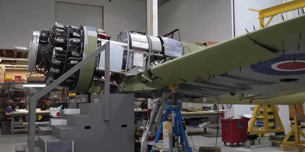

I am rebuilding a Hawker Tempest and in need of the following parts: Sea Fury ailerons, Rudder, and throttle quadrant. Do any members have any available?
Thanks,
Joe
