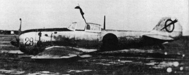

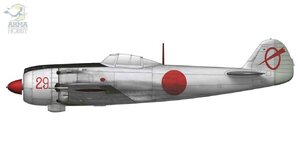

Good morning lads, as you understand my next kit on the bench will be the hasegawa's 1/32 Ki-84. I have read a lot regarding the cockpit colour, j-aircraft, aviation of japan, mixxed feelings, i know that this subject is a can of worms!!! I have also sent an email to mr. Millman, no answer yet. I have mr.color 127 (Nakajima interior color), some say something like British interior etc.
What are your thoughts?
John
P.s. I want to depict this aircraft
