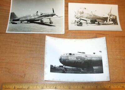

Strange back foto P-51 , Baugher P-36. Calling drgondog drgondog
  1. USAF Serial Number Search Results
  2. P51 MUSTANG - ORIGINAL AVIATION PHOTO-MOYES & BOWYER COLLECTIONS | eBay
definiely A-36 Mustang. Could be near Muroc based on landscape.
