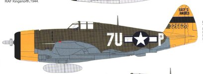

I'm looking for documentation for a particular P-47 "razorback" that flew in the 36th Fighter Group's "Easy's Angels". Color profiles suggest the rudder serial as 326628, but it appears that was in error -- actually 325528. Letter code was 7U-P. "7U" was the unit, while "P" was the specific aircraft.

43-25528
Initially assigned to the 78th Fighter Group, Lt. Peter W Klaassen made a belly landing at Duxford on 5th September 1944. Upon repair, this aircraft was reassigned to the 36th Fighter Group 23 Fighter Squardron and was lost on the 19th March 1945.
43-26628 was an L-2M.
43-25854/26753 Taylorcraft L-2M Grasshopper
Wow, thanks Fubar57 -- that pretty much confirms my hypothesis.
