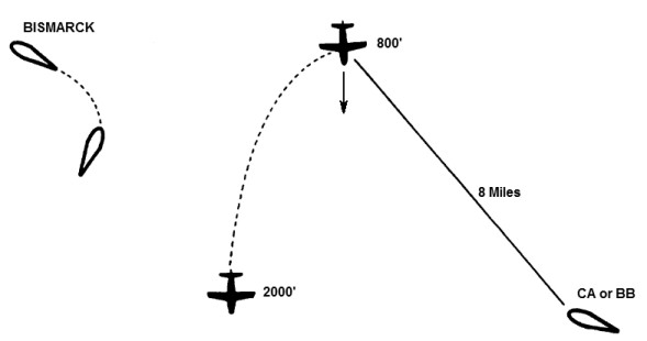

But there are other issues in relation to radio transmission from aircraft at this time. Firstly it was Morse Code based. HF voice radio came along in the early 1930s but was very short ranged (the RAF experience was c35 miles ground to air which they solved by repeater stations which was not possible for a fleet at sea, c5 miles air to air). VHF, which produced better range, was only introduced by the RAF in 1939/40 (8 squadrons by May 1940). The USN were even later. To make a Morse transmission at any distance a trailing aerial had to be wound out and in.
Think about the process for a moment. An aircraft needs to be sent out to detect an enemy. It spots it. A position has to be plotted and a signal created and coded. An aerial run out and the actual transmission made in dots and dashes. Wait for a response to ensure it has been picked up. Other signals will be made periodically until the limit of endurance is reached. And as for fighters, their role in the RN was not limited to patrolling around the fleet. They were intended to accompany the torpedo bombers and use MG fire and light bombs to attack escort ships (SEAD in today's terms). That is why in the 1930s there were single seater Hawker Nimrods and two seat Hawker Ospreys. Two aircraft for two different roles and the need for the second seat. From that came the dive bomber and the requirement for the Skua.
