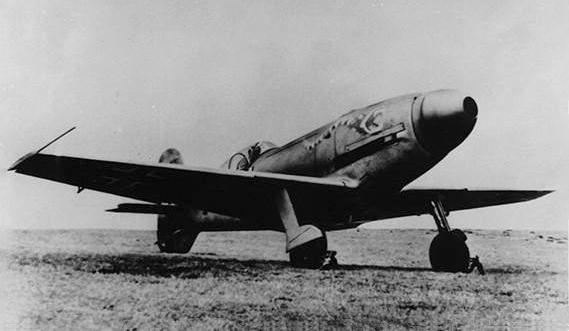

A modified version of a production fighter aircraft was never going to compare to a specially built record breaker. It was simply too big if you look at the Me209 record breaker it was tiny basically an engine with a pilot strapped to the back of the engine.
