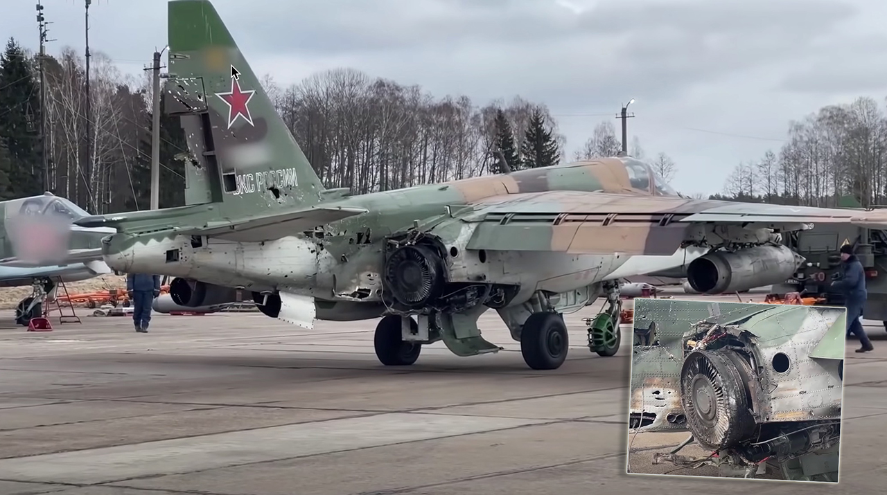

There was a picture circulating a few months ago of an Su-25 having limped back home on one engine, the other having been torn up by a SAM.
Posted on here several months ago. This is one example where the 2nd engine brought the crew home but then again this is an aircraft that is designed to be shot at and take battle damage
