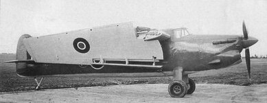

Did the whole wing and center fuselage of the Supermarine Type 322 tilt up like the Vought F-8 Crusader, or did the wings just pivit on a shaft to achieve the variable incidence wing? Sorry, if I'm missing something obvious in photos of the prototype.

Did the whole wing and center fuselage of the Supermarine Type 332 tilt up like the Vought F-8 Crusader, or did the wings just pivit on a shaft to achieve the variable incidence wing? Sorry, if I'm missing something obvious in photos of the prototype.
There is a full description of its operation in the attachments on this secret projects page. Designed to pivot around the front spar.
Thank you the attachments on the secret projects page were great! I also fixed the typo in the type number of the aircraft from 332 to 322 in my original post. Still confused if the 2nd prototype became the Type 380, but that's a minor point.
