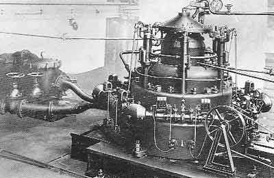

people had been working on gas turbines for years. See for one example.
There are several paragraphs on gas turbines in the engineering section of "The Naval Annual 1913" edited by Viscount Hythe for example. They knew about the theory and were wondering where it would lead even if it wasn't practical yet.
