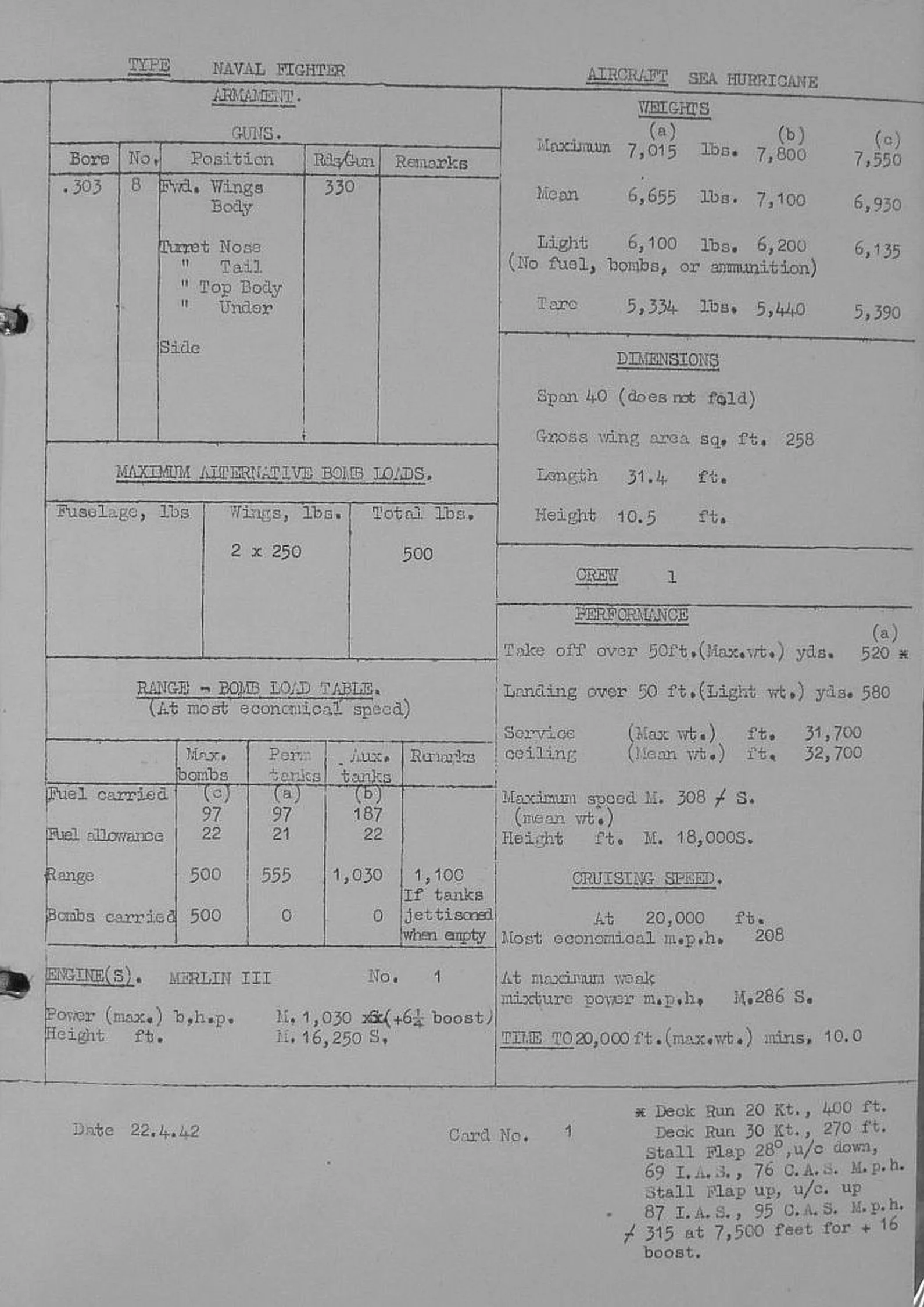

See here the Sea Hurricane (= basically a hooked Hurricane I with drop tank facility) data sheet - 1100 miles with drop tanks at 208 mph and 20000 ft, after allowance of 22 gals is subtracted.
Slipper tanks on Hurricane - please, do tell.

I did not see reference to the external tanks and 1100 mile range. Where is that precisely?
Thank you.
Still have the 136 imp gal fuel tank/s unless it was a mistake in the data sheet?

The range of the IB was 555 miles at 208mph using 76IG ( 21IG allowance - 97IG internal fuel) and this equals an endurance of 2.7 hours at 20K ft (excluding time to climb). Using a more economical speed, and a lower altitude, we could probably stretch the endurance to ~3.5 hours. Minimum consumption on the Merlin III was about 25IG/hr at ~1800rpm, IIRC.
