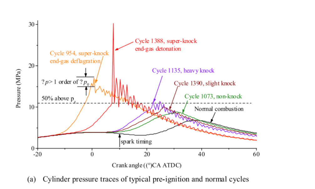

Depends entirely on the severity of the detonation, many engines run their entire lives with minor detonation. It is not a digital process and varies from minor to catastrophic in severity.
Please consult the graph below showing several different knock intensities measured. "Knocking combustion in spark-ignition engines" - 17th July 2016- State Key Laboratory of Automotive Safety and Energy
Oh and to reiterate the main point. :)
