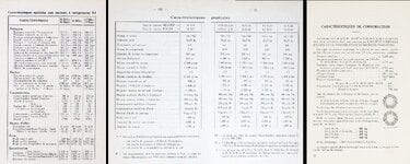

Here we are : (Right column is post-war engines, some with reinforced crankcase and crankshaft)
Thanks! Wilkinson gives a different figure of 750 kg for the 14N-48, and wikipedia gives no more than 528 kg in the specs for the 14Ks. That was the reason for my question. I wonder what accounted for such a big difference in the figures?
Wilkinson gives 750 kg for the 14N-48.
:) Thanks, but my question concerned the data on the French engines only.
Yes, I knew this strange "750kg" .... But Wilkinson is full of errors - The so-said 14R picture is a 14N, and 18P picture is a 18L...
For Wikipédia, the french notice (that I wrote...) gives 570 kg.
The documents in post 196 are officials from G&R.
Thank you.
The 1938 Janes (reprint) gives 536kg for a 14Kfs but that version is direct drive, no reduction gear. Possible source of confusion?
The 1938 Janes (reprint) also has a typo (?) as it gets the letters out of order (?) or leaves one out.
Trying to figure out the 14K letter code. I think the letter r in the 3rd position (K_r_ means reduction gear and s in last means supercharged?
Letter code maybe a hold over from the 7 and 9 cylinder engines?
In the 1946 edition of Wilkinson the 14N had gone on a diet and the -58 was now a svelte 620kg. Of course it had also lost 220hp at take-off from the 1941 edition as a -50 ;)
