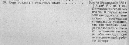

Soviet front line aircraft used 3B-78 or 4B-74 with a MON ~95. This is backed up by the flight manuals of the Soviet aircraft too (see attached):
Imported Allied fuels were B95 or B100. Luftwaffe fuel bases (both for B4 and C3) were only sightly better and had a MON of just under 80 before TEL was added.

This is especially true for the 1942/1943 time frame. I am doubtful whether Soviet crude was of the highest quality, however each nation did the best they could to get maximum performance our of their engines.
I was talking about the Baku crude oil only (now it is Azeri Light). IIRC, the quality of Caucasian crude oil (Grozny) was also high. Only these products were used for aviation gasoline production in the USSR because their refinement to the acceptable quality does not require advanced technologies like catalytic cracking. Crude oil from Volga region contains much more sulfur and required more complicated technologies.
The fact that the Luftwaffe could sufficiently fuel it's aircraft, even as early as 1941, is somewhat of a miracle in part thanks to captured fuel stocks in the 1940/1941 time frame. The process of coal to gasoline picked up by 1943 but there was never enough.
I would appreciate if you provide a reference on the role of the captured fuel stocks for the aviation gasoline production in Germany. The topic is of great interest to me.
I am not understanding your first quote, C3 was a high octane fuel. On par with US 100/130 grade, some test even state close to US 100/150 grade. Am I misunderstanding you?
I know of at least 3 Soviet oil fields that were used: Baku, Grozny and Ufimskoye. These are openly listed in aircraft engine manuals so they were used for aviation gasoline production.
There is excellent information on the Luftwaffe's oil situation found in BaMA RL 2-VI 115 pages 2-3. If you wish to read on this subject in English, Calum Douglas wrote on this as well in his book The Secret Horsepower Race.
