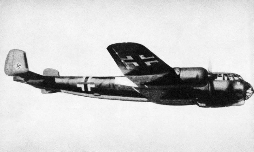

Not any different than the BMW801. Production commenced in 1940. The delay in front line service had to do with the aircraft rather than the engine. The choice of the Germans not to fit the BMW801 to other aircraft like the Japanese did with their bombers wasn't related to the engine AFAIK. After all the Do217E of 1940 used the BMW801 exclusively:
Again the engine wasn't a problem.
