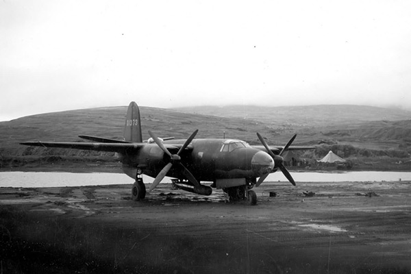

Marauder loaded with torpedo:
ETA: That ain't Midway!
It is ironic, but given the deficiencies in US torpedoes in 1942, the B-26's at Midway would have been far better off with bombs, assuming they knew about "skip bombing" which was in reality did not involve skipping bombs into the target. Imagine if Susie-Q could have slung some 500 lb bombs through the fantail of that carrier.
