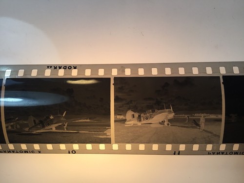

Negative RO-B RO-E ,
I found RO-B is 67 SQN W8243 Mingaladon airbase near Rangoon
seller Bought from estate. Belonged to ace Chuck Older. Complete roll in canister. Most likely taken shortly after arrival in Burma
Wow! Thanks for sharing those pics. I hadn't seen the image of RD-E before. I've been tracking the individual airframe histories for over 20 years now, to include efforts to tie squadron code letters to serial numbers. I'm working from memory but I'm pretty certain this is the first time I've seen a clear photo of RD-E clearly which appears to show the serial number W8250. Looks like another tie-up is completed.

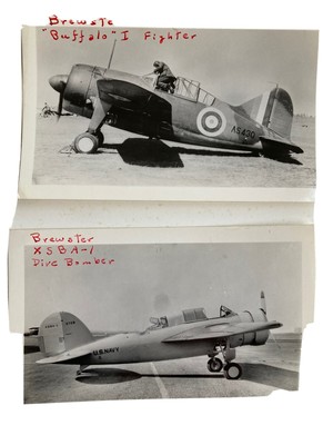

RAF AS430
Another sighting of AS430
Duke of Kent.
AS430 was the third Buffalo to arrive in the UK for testing with the A&AEE, the first being from Belgian supply, AS412 suffered engine failure, AS425 was found to have structural damage and so AS430 arrived in August 1940 before it collided with a Handley Page Hampden during an air to air photo sortie in October 1940. The pilot bailed out.
A performance report dated July 1941 came from information gleaned from all three aircraft, which stated that performance was not outstanding, although take-off run with flap was only 215 yds. Carbon monoxide levels in the cockpit were dangerously high and the fitting of fishtail exhausts didn't help, but improved flame dampening. It was easy to load the aircraft to an aft CG position, so recommendations were made for in service to prevent the CG from creeping too far aft through incorrect loading. Gunnery trials information appears to be scant, but firing appeared to be satisfactory, although rearming the wing guns was considered awkward and firing the fuselage guns at low altitude (not at high altitude?) caused oil to flow onto the windscreen.
