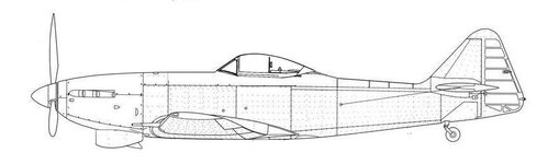

LR Daffy, with some cheating, like the canopy from 1943 on a fighter needed in 1939-41.
Anyway - fuselage of the Defiant, 1-seat now, cockpit moved a bit aft so the fuel tank can be installed between the firewall and cockpit. Cooling system relocated in beard position. A pair of cannons is depicted, the .303s will be there in 39-41. Hopefully, and on same engine type, we can get the speed to be in-between the Hurricane and Spitfire, so the 109E does not enjoy the 35+- mph speed advantage like it was the case with Hurricane. Add drop tanks of your favorite flavor.

I've thought the opposite, but not to the Defiant's detriment. There's no need for clever aeronautical engineering - a single seat Defiant would be an all metal, wide undercarriage, medium range fighter using a proven Merlin engine - and with external tanks could have been our escort fighter. There's nothing innovative or experimental in a single seat Defiant - and that's what's so annoying, that a single seat Defiant was entirely plausible to enter service in 1939. As it was, the British would not field a wide track, all-metal single seat fighter until the Hawker Typhoon entered regular frontline service in late 1942.

Fuel tanks are in the wing and in the MK II there were auxiliary tanks in the outer wings. Not really a problem as the plan is to move the cockpit back and use the existing cockpit area for fuel storage so sticking guns and ammo where the existing fuel is probably isn't a problem. Yanking the turret more than makes up for the guns in the wings unless you go crazy.
The problem is getting the plane to do the promised speed or close too it. The MK II was about 20mph slower than a MK IIA Hurricane with the same engine.
Yes the turret will be gone, the radar aerials will be gone and that flat black paint will be gone. However the engine/coolant installation was bit lacking on the MK II
Maybe they could use a "chin" radiator like on the P-40F???
The problem is not to just match the Hurricane IIA but beat it by 10-15mph and you still aren't up to the speed estimated.
The Defiant II did not reach it's anticipated speed, some of the blame was put on the radiator/oil cooler/air intake.
Now even with the turret gone you are going to have an 8,000lb airplane if you have 150-160 imp gallons of fuel when combat starts (used drop tanks to arrive) so you are going to climb more like a P-40F than even a Hurricane II or perhaps it would split the difference. If that is good enough performance in 1941 go for it.
I suspect but can't prove that the wing is going to be part of the problem.
I'd agree with that observation. Wing was neither thin nor of the small area, barely smaller than on the Hurricane.
That is my cunning plan :)
Apart from the obvious culprit - turret - we can note the draggy exhausts (as it was in vogue with British fighters in 1939-42), carb was as it was, radiator was sticking out in the slipstream like on the Hurricane, 1st XP-40, Typhoon prototype - not good. Oil cooler is a separate unit, again no great shakes there. Add the draggy wing, and there is one sedate fighter.
