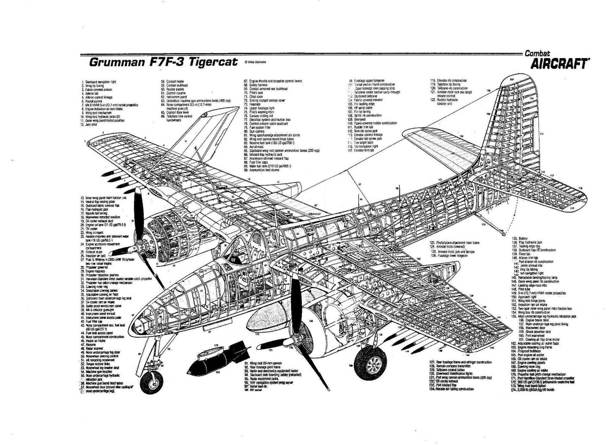

Carb air have had an ... interesting path on the Hornet. It 1st entered the intake in the LE, then ot tured 90 deg towards fuselage, then turned 90 deg into the carb.
(similar set-up was on the F7F)
My take on Merlin 130 intake on the Spitfire and the like is that they will be very similar to the Allison-egined P-40s or P-51s.
